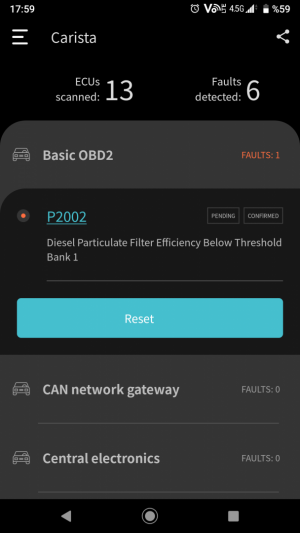

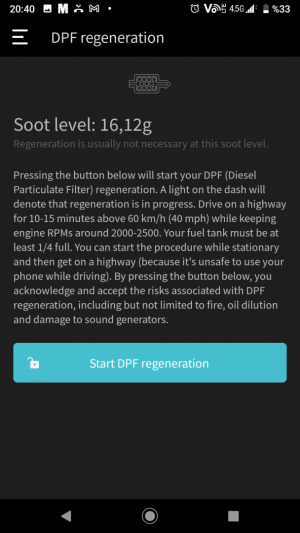

Cihaz geldi uygulama ile hataları resetledim. Dpf de gayet temiz görünüyor. Tam tarama yaptığımda da şu sonuçları elde ettim.
ECU info obtained with Carista 6.3.1 for Android:
CAN network gateway
Part #: 5Q0907530AD
Component: GW MQB Low
Software version: 1223
ASAM/ODX identifier: EV_GatewLear
Coding: 030000041F087300FB000048080F00010001050000000000000000000000 (hex)
[No fault codes]
Central electronics
Part #: 5Q0937084AP
Component: BCM MQBAB B
Software version: 0173
ASAM/ODX identifier: EV_BCMMQB
Coding: 00000842C24100534BE44000000403081000000000000000000000000000 (hex)
[No fault codes]
Steering wheel
Part #: 5Q0953507GB
Component: Lenks. Modul
Software version: 0110
ASAM/ODX identifier: EV_SMLSKLOMQB
Coding: 0600 (hex)
[No fault codes]
Airbags
Part #: 5Q0959655D
Component: AirbagVW20
Software version: 0385
ASAM/ODX identifier: EV_AirbaVW20SMEVW37X
Coding: 98CCC000000000005C0000CF004800000065 (hex)
[No fault codes]
Instrument cluster
Part #: 5G1920741A
Component: KOMBI
Software version: 7640
ASAM/ODX identifier: EV_DashBoardJCIMQBAB
Coding: 07A41A002380000800080A001400000000000000 (hex)
Fault codes:
9456433 Manufacturer-specific code
16777024 Manufacturer-specific code
ABS
Part #: 3Q0907379AF
Component: ESC
Software version: 0625
ASAM/ODX identifier: EV_Brake1UDSContiMK100IPB
Coding: 01FA62A11421096F077D060141C32580462890E06082A4F300400078C002 (hex)
Fault codes:
16401 Crankshaft / Camshaft Position Correlation Sensor B Bank-1
Power steering
Part #: 5Q0909144R
Component: EPS_MQB_ZFLS
Software version: 1061
ASAM/ODX identifier: EV_SteerAssisMQB
Coding: 0103 (hex)
[No fault codes]
Heater & air conditioning
Part #: 5G0907426T
Component: AC Manuell
Software version: 1001
ASAM/ODX identifier: EV_ACManueBHBVW37X
Coding: 00020104200100001000000000000002 (hex)
[No fault codes]
Front passenger's door
Part #: 5Q0959392E
Component: TSG BFS
Software version: 0041
ASAM/ODX identifier: EV_DCUPasseSideEWMINKLO
Coding: 003001208000040000801000 (hex)
[No fault codes]
Driver's door
Part #: 5Q0959393E
Component: TSG FS
ASAM/ODX identifier: EV_DCUDriveSideEWMINKLO
Coding: 003003208000040000001000 (hex)
[No fault codes]
Engine
Part #: 04L906056CS
Component: R4 1.6l TDI
Software version: 2371
ASAM/ODX identifier: EV_ECM16TDI03004L906056CS
Coding: 01114012430411092000 (hex)
Fault codes:
23960 Manufacturer-specific code
Infotainment system
Part #: 5G0035867C
Component: MU-E--ER
Software version: 6490
ASAM/ODX identifier: EV_MUEnt4CGen2LGE
Coding: 02730000FF0000004011000100010000000000040000010000 (hex)
Fault codes:
07203 Manufacturer-specific code
