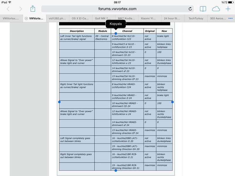

aracımda led stop var ama bu uygulama için normal stop alasım geliyor. :) uygulama hangi kablo veya programla yapılıyor bilmiyorum ama elemanlar alttaki kodları yazıp uygulamışlar.
https://player.vimeo.com/video/126065196Each set has 19 sections:
...-Leuchte20BR LA71-... is for the outer left
...-Leuchte23SL HLC10-... is for the inner left
...-Leuchte24SL HRA65-... is for the inner right
...-Leuchte21BR RC8-... is for the outer right
For each set, I'm not sure what (1), (2), and (3) are.
For (4) to (19), the light functions are grouped by 4 sections; as divided by lines on my chart:
Group A: (4) to (7)
Group B: (8) to (11)
Group C: (12) to (15)
Group D: (16) to (19)
Group 1 to 4 work as a hierarchy structure to create the taillight function.
Hierarchy as follows: Group D > Group C > Group B > Group A

Coding Changes:
If DRL: == Tail lights run with the DRLs
Non-LED:
Left Outer Tail:
Left Brake Light:
(1)-Leuchte20BR LA71-Lasttyp 20 == 13 - Bremsleuchten
(2)-Leuchte20BR LA71-Lampendefektbitposition 20 == 10
(3)-Leuchte20BR LA71-Fehlerort mittleres Byte DTC-DFCC 20 == 39
(4)-Leuchte20BR LA71-Lichtfunktion A 20 == Brake light
(5)-Leuchte20BR LA71-Lichtfunktion B 20 == not active
(6)-Leuchte20BR LA71-Dimmwert AB 20 == 100
(7)-Leuchte20BR LA71-Lichtansteuerung HD AB 20 == Always
(8)-Leuchte20BR LA71-Lichtfunktion C 20 == Standlicht allgemein (Schlusslicht; Positionslicht; Begrenzungslicht)
(9)-Leuchte20BR LA71-Lichtfunktion D 20 == Parklicht links (beidseitiges Parklicht aktiviert li & re)
(10)-Leuchte20BR LA71-Dimmwert CD 20 == 28
(11)-Leuchte20BR LA71-Dimming Direction CD 20 == maximize
(12)-Leuchte20BR LA71-Lichtfunktion E 20 == not active
(13)-Leuchte20BR LA71-Lichtfunktion F 20 == not active
(14)-Leuchte20BR LA71-Dimmwert EF 20 == 0
(15)-Leuchte20BR LA71-Dimming Direction EF 20 == maximize
(16)-Leuchte20BR LA71-Lichtfunktion G 20 == not active
(17)-Leuchte20BR LA71-Lichtfunktion H 20 == not active
(18)-Leuchte20BR LA71-Dimmwert GH 20 == 0
(19)-Leuchte20BR LA71-Dimming Direction GH 20 == maximize
